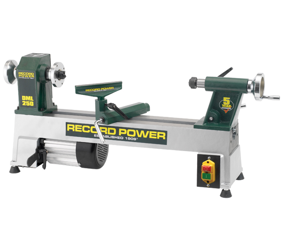

Mines one of these.
Woodworking Machinery and Accessories
www.recordpower.co.uk
I like the idea of variable speed by potentiometer, but it's no hassle swapping the belt. I have a scroll chuck, and also a Jacobs chuck (like a power drill) for the other end for hole boring.
Had an issue with it not running right, low power, would start up backwards, so contacted Record Power as its under warranty. They said, last November, that they would send a new motor, which hasn't happened as yet. Reminds me, must give them another poke.
I fixed it myself, it was the start/run capacitor, so I swapped that out and put in a new one. Total cost, about £8, as I bought two just in case. Can make use of a new motor though, if I finally get it.
